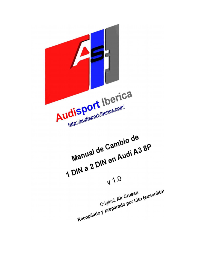

Encontrei este manual que também pode ajudar:
pt.scribd.com
Manual Change From 1 DIN To 2 DIN in Audi A3 8P | PDF | Screw | Electrical Connector
This document provides detailed instructions for changing the radio system from 1 DIN to 2 DIN in an Audi A3 8P. Explains how to remove parts such as the radio, control panel, glove box and dashboard to access the mounting space. It then describes how to remove the existing 1-DIN cabinet and...
